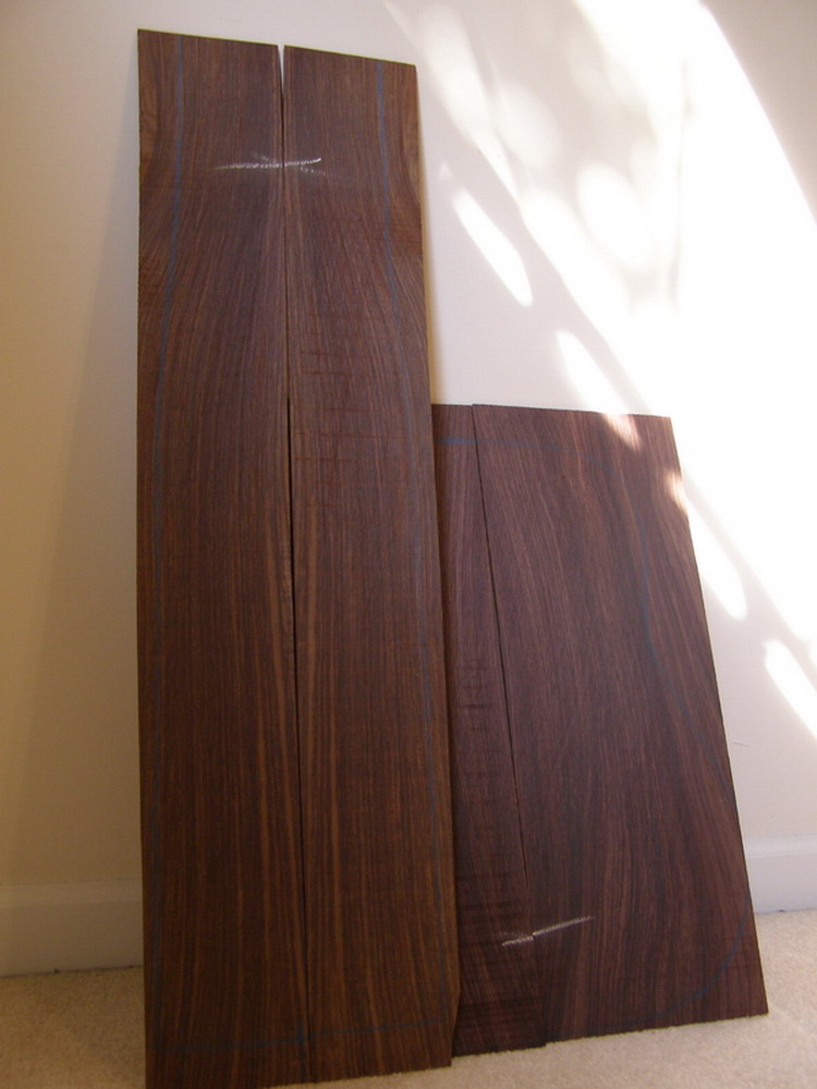

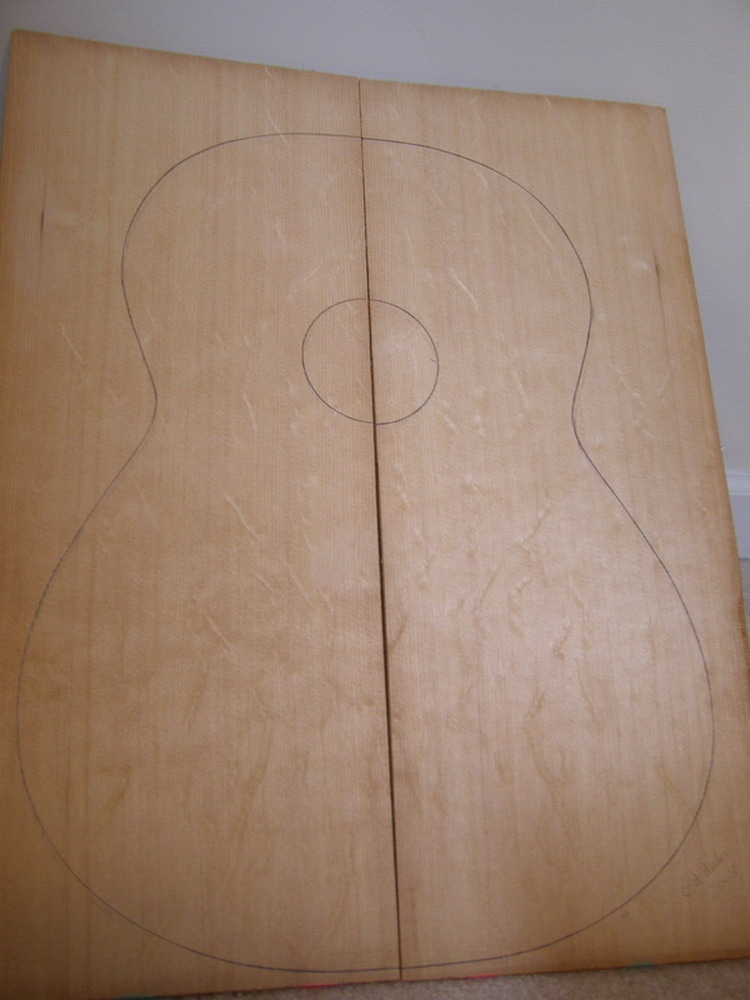

Hey everybody-
Thanks to everyone for their thoughts on what to use for my OM. I have decided on the bearclaw sitka top and a different EI rosewood set that also came from the Allied character grade sale.
The back and sides have one small pin knot in each plate that won't be noticable after finishing. It is very colorful forest grown wood and a steal at $20. I think I have about $38 invested in the top, back and sides, so they are inexpensive but still very nice.
Here they are-
Hopefully this guitar turns out well. I'm sure I'll be posting questions everyday once the build starts. It's nice to know that I have folks here that love to help.

Howdy-
I forgot to mention that the top came from Ed Dicks at Acoustic Woods in Canada. I got my Cuban mahogany sets from him too. Anyway, he's a great guy to do business with.

[QUOTE=John Lewis] Howdy-
Hehe. I was just about to post a note saying that that top looks like the twin (er, triplet?) to a couple of bearclaw tops I bought from Ed about two years ago.
I used one of the tops to build this guitar:
I gotta admit, it came out sounding very nice. But that bearclaw is some very stiff sitka. A year and a half after completing the guitar it is finally starting to sound really good.
Anyway, I mention this only because I would caution you against erring on the thick side for that top set unless you plan on stringing it up with heavy strings. I thicknessed the top set on that guitar to between .100" and .110" and it was still quite stiff. I even used a fairly light X-bracing pattern. Even so, light gauge strings are a bit on the light side for it, mediums drive the top much better.
